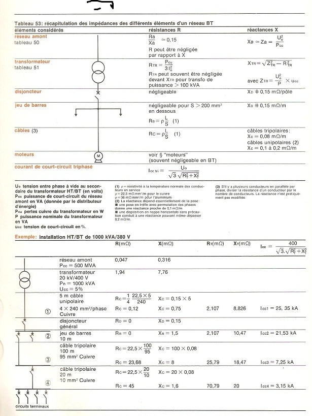

500 MVA-----U=400 V..... Ra(mOhms)=0,047mOhms..........Xa(mOhms)=0,316 mOhms
250 MVA......Uo=400V........ Ra=0,095 mOhms............... Xa=0,633 mOhms
Ra=U^2 x 0,15 x10^-3/Pcc
Xa=U^2 x 0,98 x 10^-3/Pcc
Ra/Xa aproximadente 0,15 Logo Xa= Za=U^2/Pcc
Icc=400/Raziz 3 x( Raiz quadrada de( RT^2+XT^2))
___________
Transformador
Rtr=Pcobre 3 x In^2
Xtr=raiz(Ztr^2-Rtr^2
Ztr=U X ucc /Pcc
Cabos transformador quadro BT.
Rb=Ró x L/S
Xb=0,15 mOhms /metro
L=5 metros
Scheneider 1982
